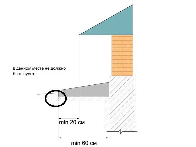

    1. First you need to check the blind area around the perimeter of the house for its integrity and for subsidence of soil along its edge. If you find a subsidence of the soil, then rainwater comes to the foundation and leads to increased humidity. The painful spot is circled in the figure. Moreover, the fungus is on the ceiling, and not on the walls or floor level.
