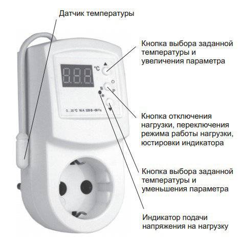

    In addition to the heating cable, a regulator can be purchased for complete control. Shows and makes it possible to program (in the photo) the heating operation. I also recommend reading an article on your topic on our website - https://engineershub.decorexpro.com/en/vodosnab/vodoprovod/obogrev-vodoprovoda.html#_4.
